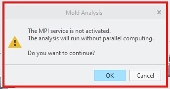

MPI Service is not activated

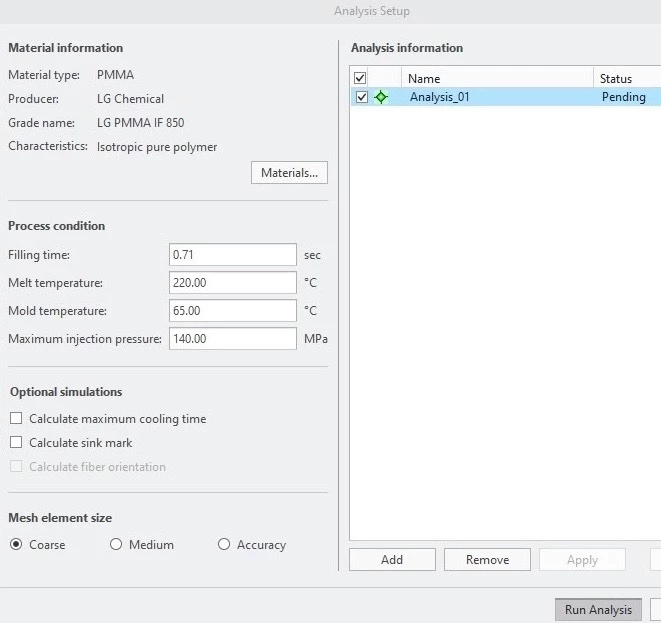

I am using Creo Parametric Release 4.0 and DatecodeM010
Dear PTC Support team
What is MPI Service? why it's not running?
Is in EMX module or Analysis Extension?
Please see attached file.

    Article - "MPI service installed with Creo 7.0.4.0 is not recognized by Creo Mold Analysis solver in Creo Parametric": https://www.ptc.com/en/support/article/cs345197
    Jul 7, 2025 7:27 AM UTC
    did you select MPI item during Creo installation? If not you have to install Creo from the scratch.
