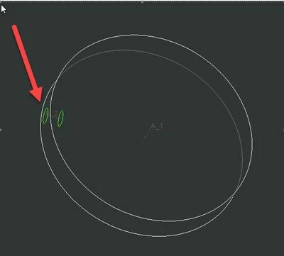

    thank you for the tip.  It certainly works for a feature that can be dimensioned from the axis (where the sketching plain of the feature is perpendicular to the to the axis).  I was not aware of the technique.  But the case I'm working with the feature's sketching plain parallels the pattern's axis so I am unable to create the angle demission (at least I have not figured out a way).
    See screen shot below:
    In the below screenshot, is the axis of the extrude feature I am attempting to pattern.
    kdirth

    Looks like you are creating a feature that needs to follow an existing set of features.
    Are the original features patterned?
    Can you create the secondary features using references to the original?
    If you can the secondary feature with pattern as a reference pattern.
