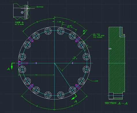

I'm not entirely sure what to accurately call these, so I haven't had much luck in finding help creating such. At the moment, I'm working to take 2D AutoCAD drawings and turning them into 3D Creo Parametric 2.0 models as well as to recreate the drawings in Creo. In particular, I'm floundering on how to make more complex section views display in my drawings.

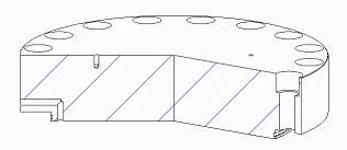

Attached is a simplified ref of the original AutoCAD views I'm trying to replicate. I can cut it like the model via an actual extrude but I can't figure out how to get a view looking flat at both cut faces at once. I've also tried to create a xsec with two datum planes in the model itself to then put on the drawing as a 3D cross section, but at that point the view doesn't display the two cutting planes as flat, instead displaying the angled side as coming out of the page and as such a portion of the outer surface is displayed and any attempt to dimension on the view is rendered skewed and worthless.

You are looking to create an Offset section. It will prompt you to make a sketch of the path the sectioning plane will take. This is not the same as a Planar section with an Offset Datum.

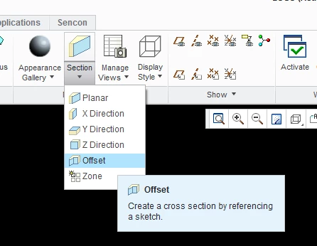

Create an offset section, menu picks are found in the attachment.

Using that option though doesn't make the two cuts lay as though the cutting plane were a flat datum plane like my company's drawn it in AutoCAD. I hope Creo's not too smart with trying to keep it looking like a 3D entity.

It will look better on the drawing when you create the section view.
