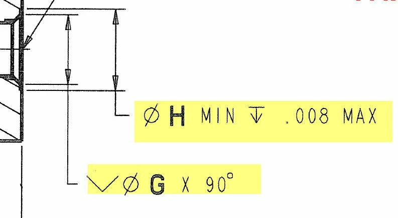

Hey Guys.
It's been awhile as the company I work for uses SW; we do however have 2 licenses of CREO 2 for legacy drawings.
Since I don't use Creo much, I can't remember how to change a "Dimension" to show different "Fonts" (see pic).
(I basically want the G&H to be Bold and .25, while the remaining text should be "Default Font" @ .20
Any help would be appreciated.
Thanks.
-Art
18-Opal
October 7, 2019
Hi Art,
It isn't possible to change the font for individual items, with a dimension call out.  You can do this for a note, but not for a dimension.
Amit
