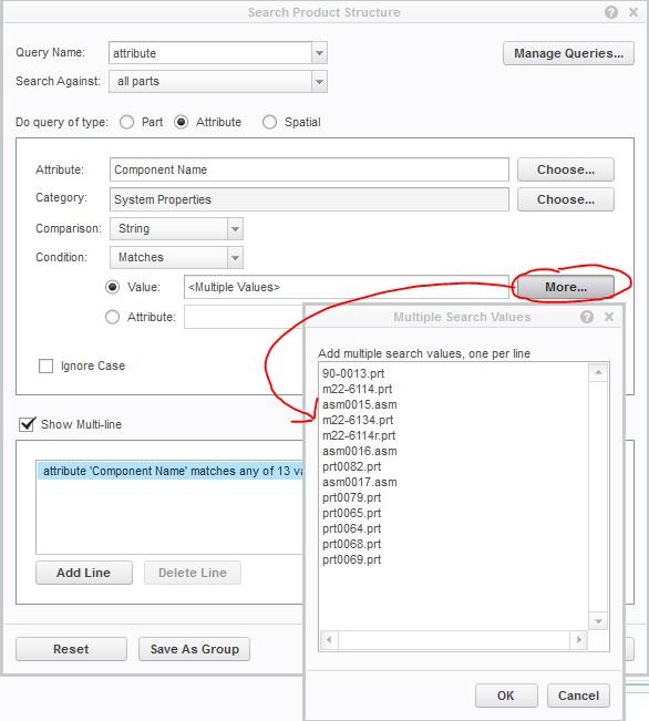

May 13, 2015
Always multiple ways to skin the cat! In Creo View 3, you can use the search below...basically select the "more" tab in the search UI and paste in your part numbers into the table.
