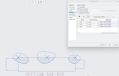

I have a part similar to the one attached that I need to create three cutaways on in the same view. I am using the zone function to create them and am having some trouble. Using planes, I have figured out how to get two of them, but I can't seem to get the third. I have marked in red the location of the third cutaway in a screeshot below. Is there a way using the logic in the zone definition I can get the third in the same zone? Also, is there a way to edit the hatching on the zone?

I'm not sure really what you are trying to do. But if I want cut away areas on a view, I add local cross sections for each area. Can be the same section or different sections to meet your needs. I am likely way wrong in my interpretation of your question but I thought I would give it a shot.

I'm trying to use the zone command to create the cutaways, but I can't create three separate zones and apply them to the same view because only one 3D section can be applied to a view. So, I am trying to get it done in one zone.
