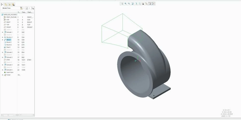

I made a blend with 2 sections, it says it generated successfully, but then when I move onto the next step of trying to create rounds on the edges, the blended part I just created doesn't appear for me to select? What do I do?

Did you Create the blend as solid or surface?
also check if solid layer is hidden by any chance.

Can you share the part? By any chance, is it at assembly level? Or part level
November 18, 2019
I can't share the file itself since it was made on a work computer. But here is a picture of what I see the blend. I can see the outline, but not the actual 3D model of it itself. Capture.JPG

Check feature type, is it surface and also layers in part, possible it is surface and hidden in layer.
