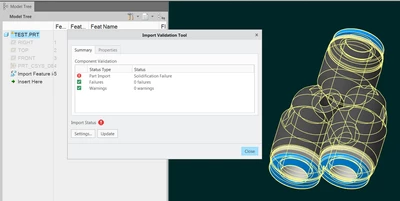

Hi all,
recently, I was messing around with the import settings for STEP files.  I didn't think I was saving any of these import options into some import configuration but since then something seems amiss as I often wind up with this situation:
Sometimes changing the settings to "ignore" the error works (in that the warning light goes away) but I have had times where the error started coming back after trying to make further changes to the imported model.
Looking for any advice from anyone with experience with these import validation errors, or STEP import settings and where they are "stored" in a typical Creo installation and how to restore them to default settings?

The config.val file can be configured and exported directly from the import validation tool in Creo. You can click on the settings button that is shown in your screenshot and export a file from there. That file would then be what you put in your start in/working directory. Config options to configure import validation were introduced in later versions of Creo.

This is fixed in future versions of Creo but in Creo 4 there is a workaround. You can store data validation settings in a file called config.val and put it in your start in/working directory. We used our launcher to drop this file into the working directory for the users on startup. You might run into issues if you are working on the network and users are changing working directories.

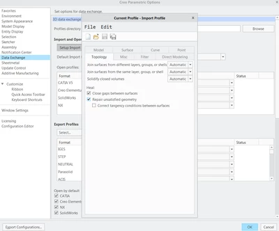

I think the software somehow keeps a record of the import settings in a "current import profile".  These settings can be exported and specified to be used with config.pro option intf_in_profile_default and can be edited by an "import profile editor" tool which was available in the ribbon, but now I see this has been moved into the Creo Parametric Options menu /  Data Exchange section.
I changed this setting and I think my solidification errors are I think less frequent, but time will tell:

Thanks @Tdaugherty , I think this is good to know.  Just to clarify, this config.val file is not used by the newest versions of the software?
May 1, 2022
I think it still works but they added config options to make the disabling process a little easier. Check out this link.
