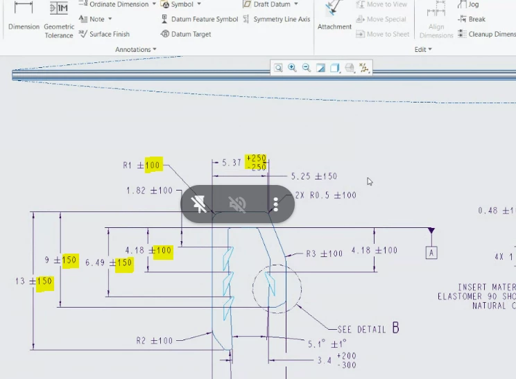

my drawing is showing wrong tolerances
my drawing is showing wrong tolerances please see attachment.
the points are not showing even i have entered decimal value.
please help.
Br,
Sandy

I think in your drawing following detail option is set:
display_tol_by_1000 YES

Sandy712-AmethystAuthor
Mar 13, 2024 12:54 PM UTC
hi @MartinHanak
where can i find this option?

Mar 14, 2024 11:48 AM UTC
Is the tolerances showing wrong in the model also?
If so, also check the model detail properties for that same option display_tol_by_1000 YES
In the model (not drawing), FILE - PREPARE - MODEL PROPERTIES - DETAIL OPTIONS CHANGE  and look for the option there also.
Mar 14, 2024 12:46 PM UTC
no the value is 'no'

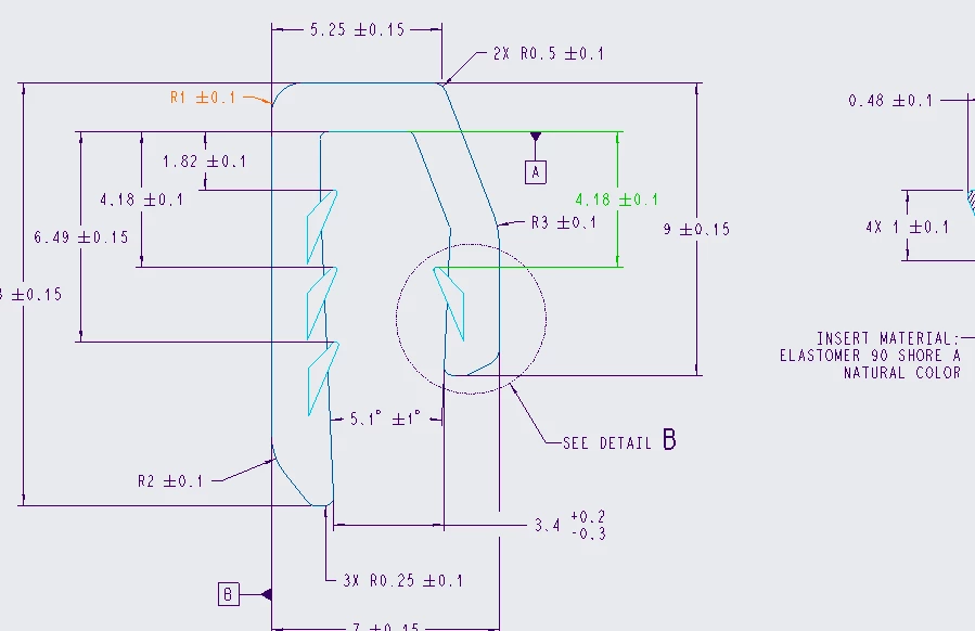

Mar 14, 2024 12:50 PM UTC
i have attached the CAD and drawing. could you please check and let me know. in my colleagues system it looks fine see attachment tol.png
