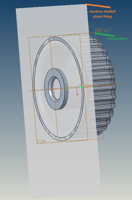

I have a model from a previously released Assembly that has a mystery shaded plane "thing"...it is not a plane, not selectable, not in the model tree, not in any layer including solids, is shown in everything: the drawing, assembly, the generic prt and both family table prts: which indicates the item is not formed on the asm or only on a family table prt (must be on the generic).  I need it hidden.  Also - how on earth is this possible?  I have tried hiding everything in the layer and model trees...everything including the solids...it always stays.  It is NOT shown if I switch to a non-shaded view on the drawing only (remains no matter the view in the open model).
Creo 9.0.3.0.

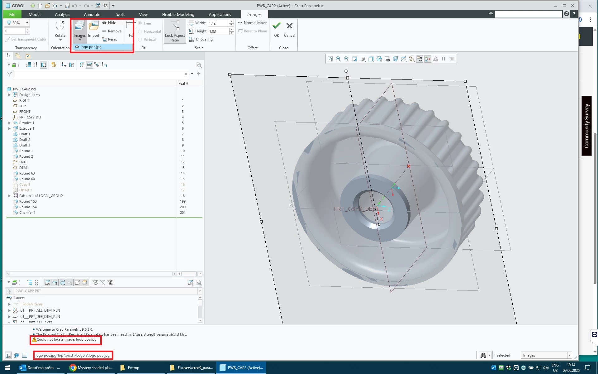

Looks like a missing image.
View tab > Images > Images > select image and Hide or Remove
pb_max10-MarbleAuthor
Jun 9, 2025 5:17 PM UTC
That was it!  (Images is under Model Display on my version).  Thanks much.
see read rectangles in uploaded picture.
