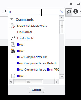

Hi all, does anyone else agree with me that the N-sided surface feature is a little gem that deserves more respect? It is buried so deep in the software that most new users as well as more experienced users don't even realise it exists. I am finding more & more instances where this feature can be used & it produces some truly outstanding surfaces. It is such a shame that it is hidden from view, that it is not readily accessible in the UI like other features such as Boundary Blend or Sweep. It is also a shame that PTC cannot bring this feature into the 21st century as they have done with other features, bring the UI in line with the rest of the software, give it a face lift as it were. It would be great if they could enhance the feature too. To be able to change the resultant surface a little by being able to move the central point where all surfaces converge would be awesome. Come on PTC, breath some life into this wonderful feature, give it the respect it deserves, don't continue to hide it away, let new users experience the many uses for this feature, I don't think they would be disappointed.

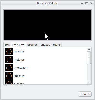

Ok so you sparked my interest.  Were is this located?  Are you speaking of the sketcher pallet use for 2D sketching and doing a fill surface? nside.jpg
June 8, 2017

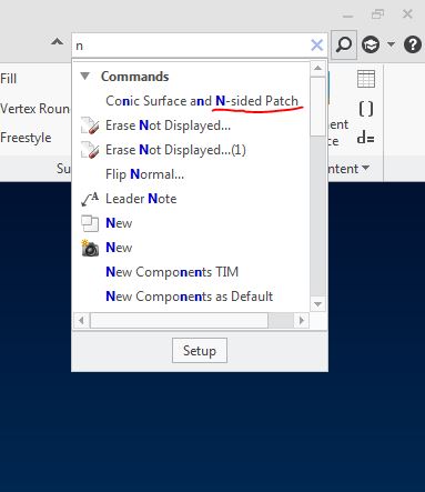

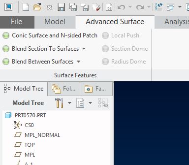

Hi Ron, the only way i know to access the the feature is through the 'command search', see the image below. I have customized my UI, creating a new tab called 'advanced surface features'. I have added the feature to this tab so i can access it without having to search for it each time (see bottom image).

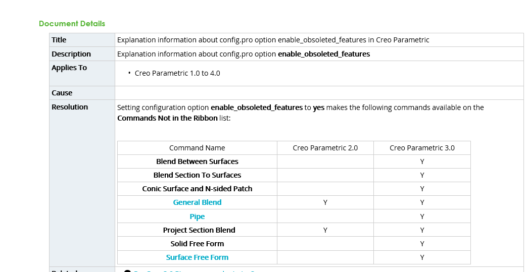

AHHH, found it...add the option ENABLE_OBSOLETED_FEATURES YES to your config.
June 8, 2017
That did it I enabled the obsolete features in my config and now I have those things.
June 8, 2017
I have that option too, did not spot it, I did not even realize I had it, but I have had Creo 3 running for ages now, I must have added it at some point, just don't remember. Just checked my Creo elements pro-5 config & that option does not appear there. Looks like this is a relatively new option. Anyway, now you have it working. Give it a go, it is very fiddly to use, but once you get the hang of it, worth the effort. Good luck.
