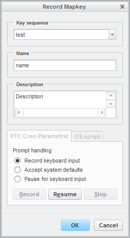

Another location where they do this is if you look at a mapkey in the config.pro.  Here I compare the dialog to the mapkey:
Dialog:
Mapkey in config.pro file:
    mapkey test @MAPKEY_NAMEDescription;@MAPKEY_LABELname;;
That is the exact mapkey saved and copied for the above dialog.  That's right, description is Name, and name is label!!!!
So to summarize:
1) Starting a new part:
Name = Filename = Number
Common Name = Name
2) Mapkey config.pro file:
Mapkey_Label = Name
Mapkey_Name = Description
Ah, the inanity of it all!  Anybody know of any product ideas to correct this?  I haven't found any yet.  Or perhaps PTC could just correct it...at least one of them?
