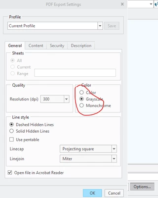

Jul 27, 2021 8:13 PM UTC
When saving as a PDF, select options and chang color to Grayscale.

Hello, I am a bit further in the weeds with this.
Yes, I have been using greyscale for the creation of PDF.
I have been using print preview to manipulate custom pen table real-time.
Need pen 3 for phantom font to equal pen 7.
