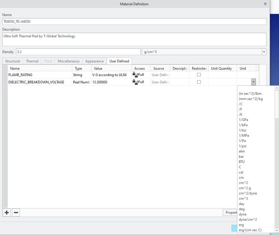

I would like to add a material property called DIELECTRIC BREACKDOWN VOLTAGE, units are [kV/mm].
When I add this feature to MATERIAL USER DEFINED features tab, I cannot select this unirs from the drop down list because it is not present.
Is there a way to add a few units to that list?

May 28, 2021
I'm attaching here the tab/list I'm referring to.
Thank you!

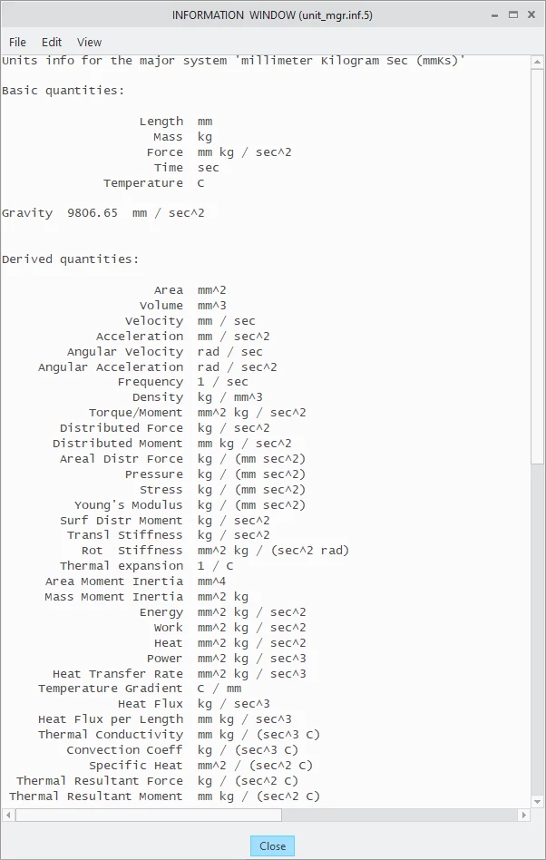

I have followed it and tried, but it seems CREO 7 does not recognise V, or any other potential name.
I tried to define it (see attached new_unit_2.png) but there is no way to do that because it does not recognise Ampere either (see attached new_unit_1.png).
Following the instructions below:
File -> Prepare -> Model Properties
Units -> Change
System of Units -> Info
a text file appears listing (I think) all/most of the units recognised. Unfortunately, I cannot see any reference to Volts, Amperes, Ohm, etx., so, it seems it will not allow me to add an electrical-related units.
Is that possible?

May 28, 2021
I don't know if anyone else has an idea, but it seems that there isn't any way to define electrical units. There's a Watt in the standard units, but not enough standard units to define a Volt. Seems to be a bias towards thermal and physical units. Maybe a custom system of units would let you define your own "basic" units? I don't know - it's not something I've ever had to attack.
