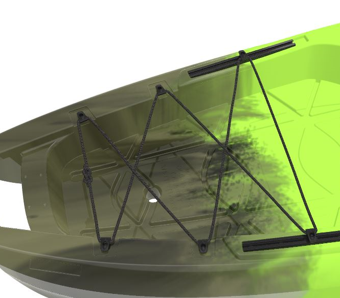

Thanks for the response. I will be using Keyshot as the rendering output for graphics to use. I have modeled bungee cords using creo and added textures and such in Keyshot as a final render.. Here's a sample of a past assignment.
April 28, 2016
Very nice work.  You have much more patience than I do
