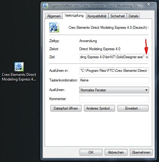

Have you already started the PE with the -v option.
It will open a DOS window that show the start of all the details that are loaded while the start of the program.
Make a copy of the start icon of the PE, right-click the icon, choose properties and add -v to the end of the command
Then start the PE with this icon.
Probably this will show where the module hangs.
Sep 11, 2013 3:34 PM UTC
Thank you. I did that and it shows that it hangs after "initializing base_start"
