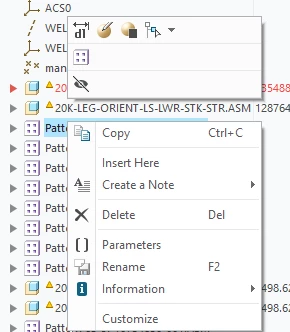

No delete pattern option in RMB
Why would I not get the "delete pattern" option for a pattern?  It's an axis pattern.
I checked placement, it's good. Nothing related to the pattern or the component placement is failing.
I happen to have 4 patterns of the same components and none of them are offering a delete pattern option.
Alternatively, the next 4 different components are all pattern (axis pattern also) and they all offer the delete pattern option.

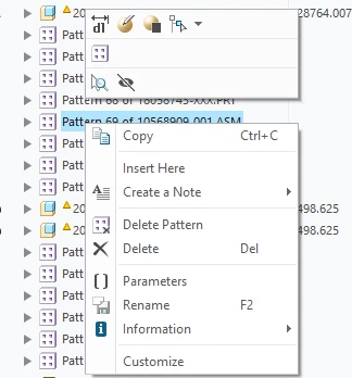

2 images below, first on is the pattern RMB with no delete pattern option
2nd image shows another component with a delete pattern option.
(I had to cover some of the filenames due to I cannot expose my customer name)
There are some random model errors. I don't have control over all the models, so sometimes I have to live with errors

Chris3
Aug 6, 2024 5:57 PM UTC
Sound to me like there is a dependent reference. Sounds like the model is not set to Read Only?
Are you working in a PDMLink session? If so does it change if you go offline?
Have you tried backing up the assembly and deleting everything up to that pattern and then seeing if delete pattern shows up?
Was the pattern added with a toolkit?
StephenW
StephenW23-Emerald IIIAuthorAnswer
Aug 6, 2024 7:23 PM UTC
Good troubleshooting suggestions @Chris3
PDMLink yes. No read only on the top level assemblies or anything I am working on specifically.
No toolkit stuff, all just plain-old fashioned assembly.
I deleted all "noted" assembly references and that didn't work. I used insert mode and tried with no luck.
Tested deleting everything after the pattern (including all sections), no luck.
Restarted Creo, went offline, opened master rep and hey, DELETE PATTERN is now available! I thought I had tried master rep before, maybe not...
Went back to online workspace, opened master rep, DELETE PATTERN is available...so apparently I didn't test or maybe opening the rep first, then changing to master rep didn't work, not sure.
In any case, this seems to be associated to the simplified rep I am using. In general, this specific rep is everything, but with the internals of "others" equipment removed to make the model faster and to produce a customer drawing without propriatary internal components shown.
I had deleted and re-assembled one of the 4 patterns already and along the way discovered a separate assembly issue, so it was a good exercise in any case. Honestly, if I had gotten re-directed this morning here at work I would have already deleted everything and re-assembled.
Thanks everyone for all the help. I'm going to mark my post as the solution since it has the specific resolution but it was specifically @Chris3  post that got me to test stuff I hadn't tested previously that led to the solution.
