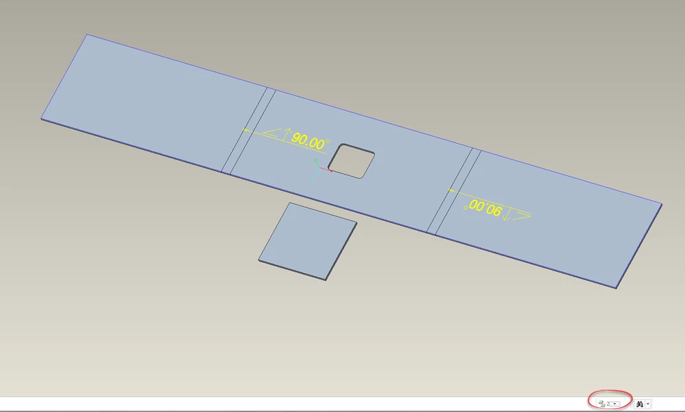

You have one continuous piece as shown in the picture of your model. There is only one piece. Here is a picture of a model with two pieces and how the icon indicates this. This is in sheetmetal mode in Creo 7.

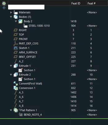

Could you explain exactly what entails "two (or more) distinct solid geometries that are not connected"?  The model tree below has extrude 1 and 2 which are a connected body and we are still receiving the error.  I would think this is distinct geometry.
