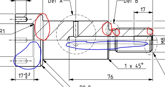

I want to remove hidden lines in my half section (circled red in attached picture) but still have hidden lines activated in the remaning part of the view (circled blue in attached picture) - how can I make this happen? I'm currently on Creo 11
Thankful for all the help I can get.

I don't think you can do that directly, at least to my knowledge.
You can use edge display under the layout tab to erase the specific hidden lines you don't want to see. Its a very manual process and if it is a lot of lines, it will not be a very pleasant experience.

Set the config option "hlr_for_xhatches" yes in config file and restart. Should remove the hidden lines in the section side only.
Apr 10, 2025 12:21 PM UTC
Even with Edge Display Rounds and Cosmetic Threads can not be removed.
