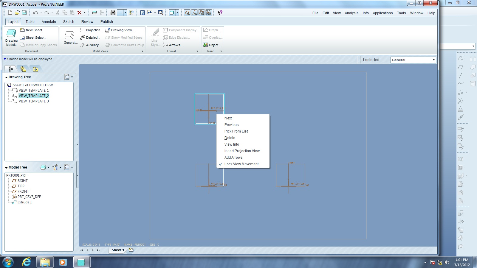

I have brought a fresh workstation of HP Z600, I have installed Wildfire 5.0 M060.
But I cannot find "Properties" option on my RMB at any particular view in drawing.
I have checked with different date codes but the issue reamains same.
I have crossed checked with Creo Parametric where is works fine. I can see the Properties option at my RMB in drawing.
I have even tried the same exsercise after formatting the machines but not helpful..
All the configuration of the Woekstation are according to PTC software/Platform Matrices.
Please suggest me with some solution.

Can you give a screen shot of the options showing in WF-5 M060 ?

Please find the attached image.

It a new pro-e installation this is a real strange problem.
I have also never customized RMB options
I am not sure if there is any options to customize RMB options
I can see that there is another option is also missing (move to sheet)
I would advise you to log a ptc case for this.
Another thing I would advise(But not sure will work for you or not)
As you said this is a new workstation; Many times pro-e behaves differently because of non-updated drivers.
I would advise you to update the system including graphics driver
