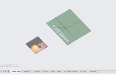

Not able to Control Images in Creo 3D model using Layers
We add multiple images to our Creo 3D cad model. But i can not control it through layers states, I want to show one image in one Combined state in MBD and want to show second image in other Combined state.
Is their any process/method creo parametric we have. I am not able to find any on helptext.

If you put the image on its own datum, you can suppress that datum in a simplified rep and the image will disappear.
