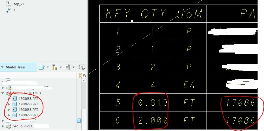

I have created an assembly with the flexible components and controlled its length through variable items.
based on the assembly I created the repeat region BoM table in the drawing. but the drawing BoM shows that, each component as a separate line item even though it has the same part number.
Also, I noticed that Creo is combining the flexible components that are in same length.
Pls. suggest an idea to combine these parts into single item with correct quantity.  Refer uploaded image..

please understand that repeat region has some functionality that doesn't allow you to do what you want.
Download and investigate my next dataset.
I created new repeat region without relations and without &ASM.MBR.FT. It contains one row related to gasket.prt.
If you add &ASM.MBR.FT into 2-nd column you will see two rows related to gasket.prt. That is current repeat region functionality. You cannot change this behaviour.

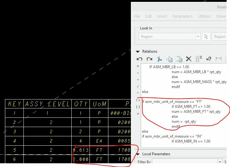

Hi, Thanks for the quick reply.
Refer attached image for the current relation associated with the repeat region table. it appears that, the current relation is same as what you mentioned.
but still BoM table reflects the flexible components as separate items. pls assist me.
it is difficult to guess what is wrong ... please create test data (simple assembly + drawing), pack them into zip file and upload zip file. This enables other users to investigate your data.
