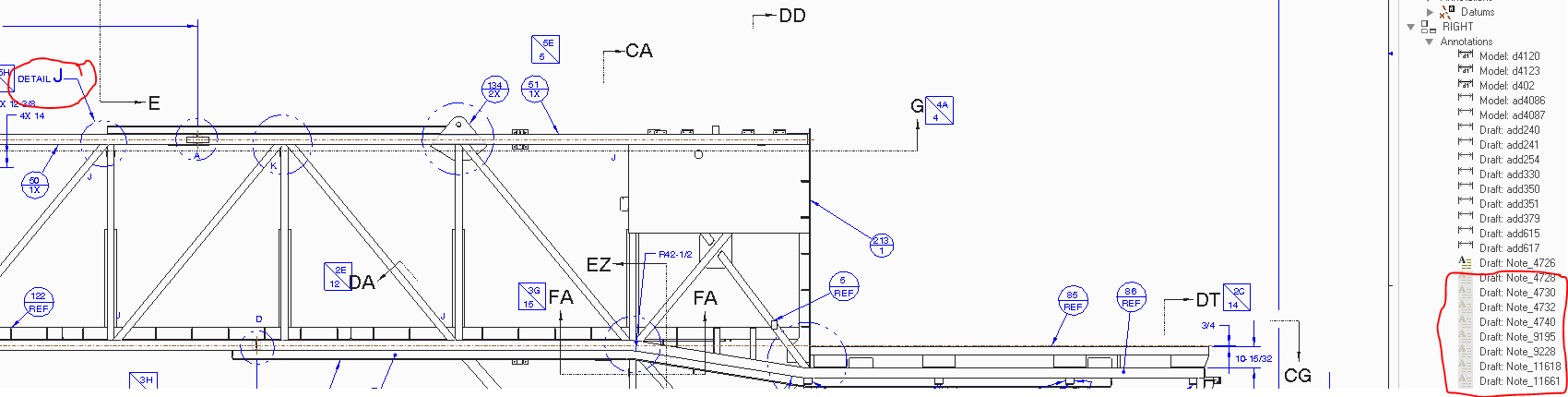

I have a drawing and am having an issue where the notes that callout the detailed views from the main views are erasing themselves. It is a 24 sheet drawing with lots of detail views. I don't want to have to keep fighting this.  Has anyone else seen this as a problem?
In the view below, I have just unerased the callout for Detail J and all of the other callouts are still erased.  This has been happening for a while with this drawing and I don't know why. Does anyone know why and what I can do to stop it?

I believe this was happening randomly to us on Creo 2 or Wildfire 5 (I don't remember which). I think we finally got passed it when we upgraded to a newer build code or a new release.
It was frustrating because it wasn't on all drawings and it was somewhat random (or maybe it was only on a few specific drawings).
What build of creo are you using?
October 25, 2016
Sorry, Using Creo Parametric 2.0 M220.
