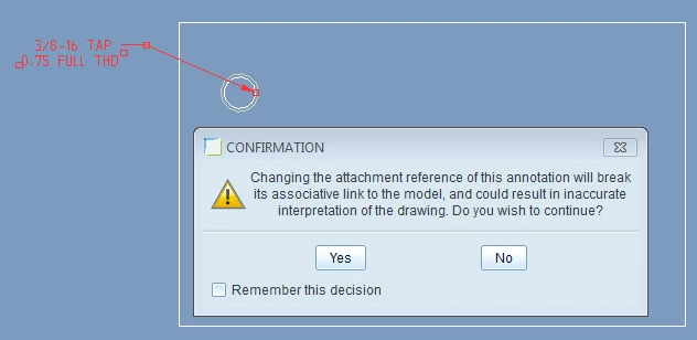

I guess I wasn’t very clear. We currently use standard hole features with customized notes (callout_format in hole table) for all of our holes (taps, counter bores, etc.). The hole feature note is shown on a drawing using the Show Model Annotations functionality. The problem with the stock hole note is that the anchor point cannot be moved. This leaves the note leader in an undesirable location. I would like this feature note to behave like a dimension when shown on a drawing. While I can change the placement of the note in the model (or create my own note for an entirely different feature (like an extrude), I haven’t found a way to make the model feature note behave in a drawing the same way a dimension does (stay normal to feature, automatic anchor movement, etc.)

Anchor point cannot be dragged. Attempting to edit attachment on the anchor point causes an error:
[cid:image001.png@01CDEE8A.CDD02440]

The Anchor point cannot be moved in Drawing, but you can move it on the model.
A pain in the… I agree.
