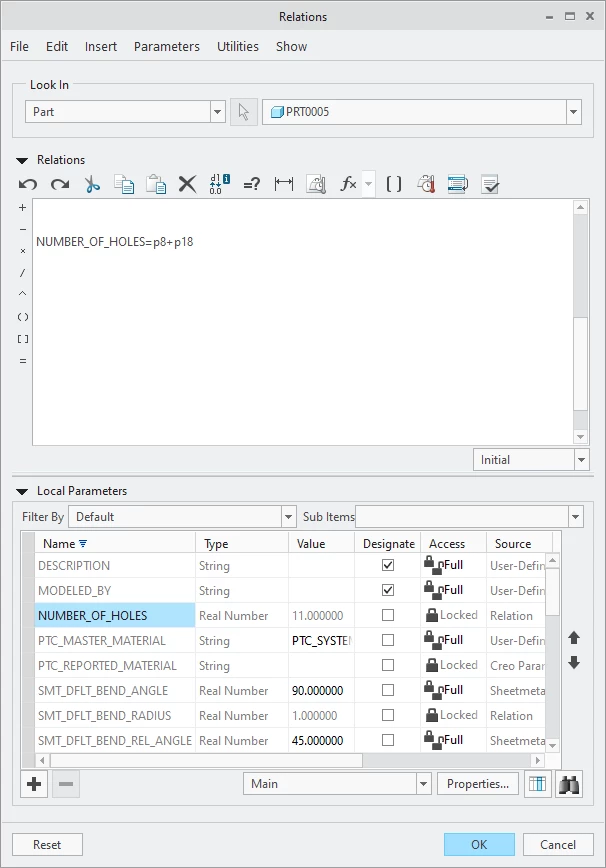

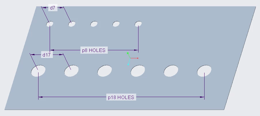

Jan 21, 2023 8:48 AM UTC
every pattern contains "dimension" representing number of instances.
Therefore you can create relation which counts hole quantity,
NiruSatya10-MarbleAuthor
Jan 23, 2023 6:07 PM UTC
For this I'll have to Manually feed this info into Relations and that's the current practice I'm following.
But I'm looking for a way of Automatic Hole Feature Recognition into Parameters / Relations.
