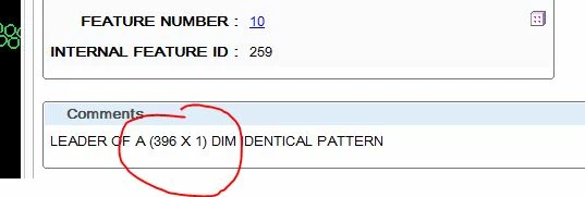

Number of instances in a FILL pattern
Any suggestions on finding the number of instances created in a fill pattern? It's odd shaped so not easily mathematically figured. I sure hope I don't have to touch each dot to count them!

From the model tree: RMB on the pattern, INFO, FEATURE
Then see the comment line:
[cid:image001.jpg@01CF912D.5D24EA90]
In this case, it's 396.

Thanks Dan and James. Took 12 min to get an answer that PTC Tech support didn't know and has been on it for 2 hrs so far.

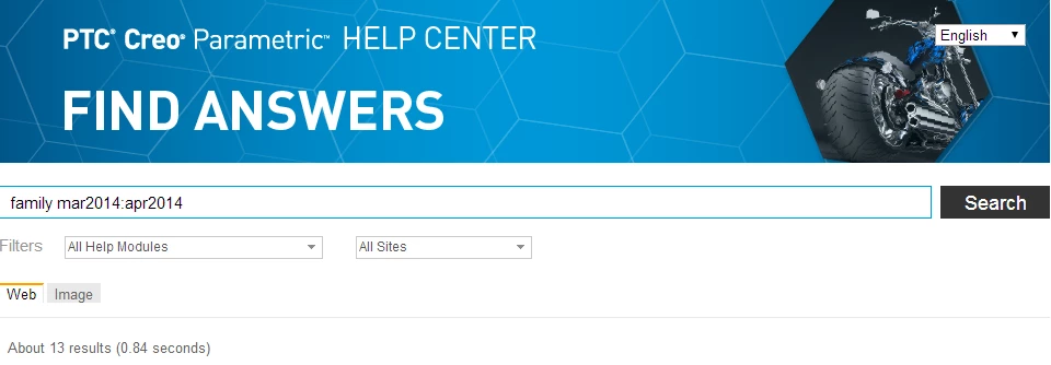

July 15, 2014
Neal

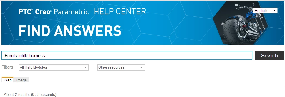

I hope you have noticed that when you visit help.ptc.com you do not require a support agreement to view the Creo online help centers, and is in the opposite direction to your scary thought.
If you have access to the web then I encourage you to take the new help center for a spin and learn how PTC are using the best technology to provide end users with the information they need as quickly and easily as possible.
Below are some examples on how to search for content and narrow your results using standard google functions.
Visit help.ptc.com and select the Creo Parametric help center,
* In the Search bar, search for Family in all help centers
o [cid:image002.png@01CFA048.55CCFA60]
* Narrow your results by excluding a particular word for example Family -harness
o [cid:image003.png@01CFA048.55CCFA60]
* Narrow your results even further by searching for a particular title for example Family intitle:harness
o [cid:image004.png@01CFA048.55CCFA60]

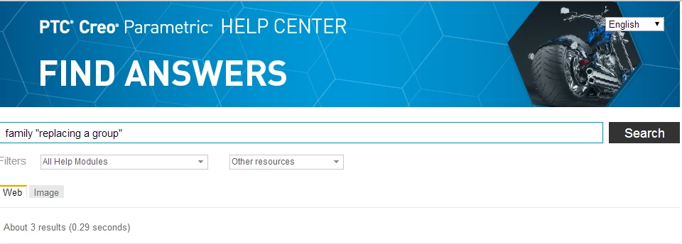

* Or Narrow your results by searching for an explicit phrase for example Family "replacing a group"
o [cid:image005.png@01CFA048.55CCFA60]
* If you check on All sites then the help center will also search PTC Learning Exchange, PTC User Community and PTC YouTube. Searching for just family in all help modules and on all PTC sites then you will receive lots of helpful information from multiple sources. Of course too much information is not useful hence the filtering examples I provided above will help you narrow your results allowing you to find answers quicker.
o [cid:image008.png@01CFA049.86B57750]
* And when searching all sites you can also search for content posted within a specific date range for example family mar2014:apr2014
o [cid:image007.png@01CFA048.55CCFA60]
In summary I hope the help center will help you find your answer quicker and easier. And I hope all scary thoughts are now demolished
Cheers, Jim
