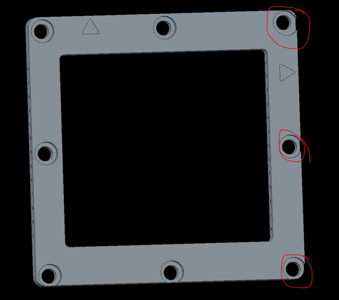

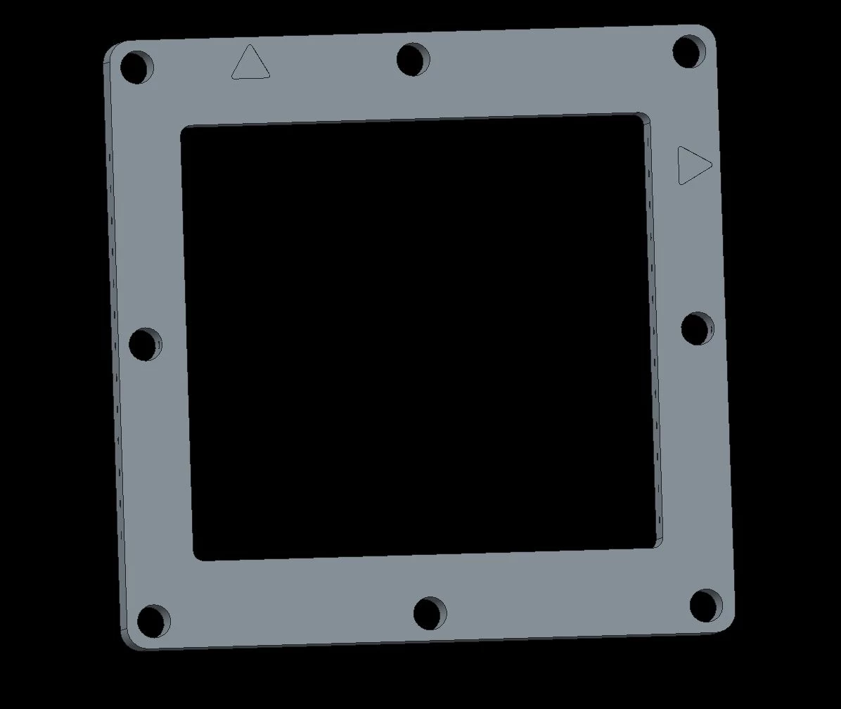

I have created a hole pattern using the Point method in the dropdown menu (Pattern --> Point --> Sketch).  For some reason when I try to have the hole have a counterbore, the hole locations shift offcenter from the original sketch location.  Without counterbore it seems to be fine.  The pictures attached are me simply changing the hole type to/from counterbore.  I did not modify the sketch nor is there anything that would link back to it (that I have put in).
I've had this happen before on other parts but it seems to be random.  I'm modeling this part in aircraft coordinates so the face is at an angle with respect to the original coordinate axes/planes.  Could this have something to do with the issue, even though relative to the surfaces all the features are perpendicular?

What I do see all too often with less than stellar hole locations that the origin of the master patterned feature shifts.  It is easiest to find by looking to see if you have an extra hole or holes in the pattern.  The Pro|WorkAround^tm is to provide a specific origin when the option is available.

I'm using Creo 3.0 but it seems your workaround was what I needed to fix the issue.  Thanks!!

Glad I could help.  If you ever see something funny about the black preview dots near the origin, this offset origin is likely the cause.
