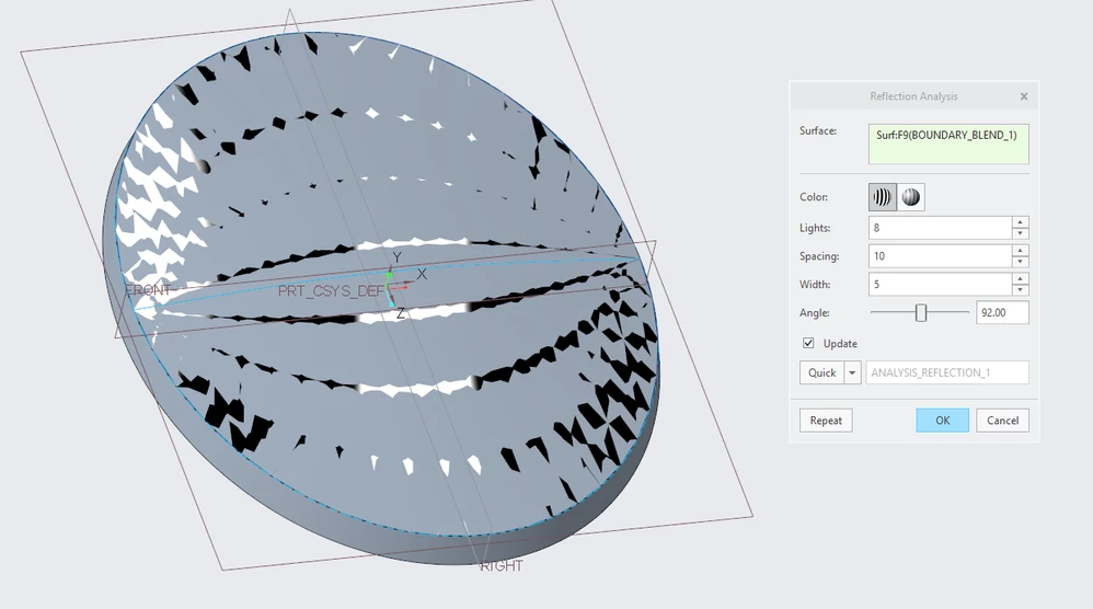

Odd patches blocking my surface analysis
  • October 29, 2019
  • 1167 views
Was trying to analyse reflections on my surface, it results in weird patches blocking the reflection, any advice to change config settings to get rid of this?
Thanks!
Best answer by tbraxton
It appears you have two congruent surfaces which is causing the interference patterns. If there is an extra surface, hide it.
