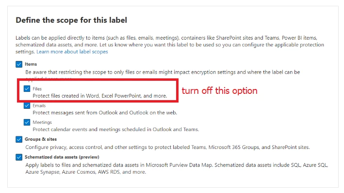

Sep 2, 2023 6:43 AM UTC
configure sensitivity labeling using information located on https://learn.microsoft.com/en-us/purview/sensitivity-labels page
Aaronm8714-AlexandriteAuthor
Sep 7, 2023 10:50 PM UTC
Unfortunately, this is controlled by the company and cannot be changed.
Oct 12, 2023 5:24 PM UTC
Unfortunately, all options are blocked by company policy.
