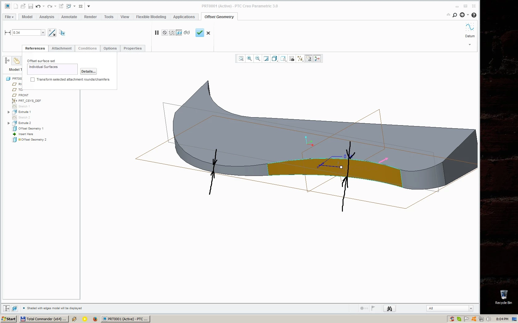

Offset help?
Having problem figuring out how to make curved angle extrude, so the edge of extruded cuve stays let's say "paralel" to bottom. I added the picture to be more clear. English is not my primary language. Want to get maked edges from picture same distance from bottom.
Thank you.

Finded this tutorial. https://www.youtube.com/watch?v=Fb6gT_0UVoI . This is what I needed. Spend so much time , and it was this easy.... Thank you once more.

You will have to give up the planarity of the the connecting surface.
Try this; offset the lower curve to where you want it.  Now use boundary blend to connect it to the back edge.
This will show you what you are actually asking.
