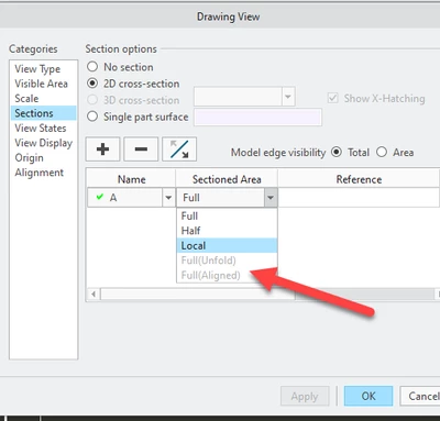

Offset Section View is not displaying properly in the drawing
I created an offset section view that basically cutoff the top and front of my model to show the inside but when I go to make the drawings either the top or front is showing. It only cuts off one either font or top and shows the other but in the model it is working perfectly and there are no errors. Is there a step I am missing when I create a view?
StephenW
Mar 1, 2023 7:05 PM UTC
Mostly likely you need to select Full (aligned) or full (unfold) and give it an axis reference to align or unfold about.
3-Newcomer
Mar 1, 2023 10:21 PM UTC
I have tried that and the full option works better. The full (aligned/unfold) causes my Creo to freeze and I need task manager to leave it. The best I can get is when I create the section while the model is on the right view and then switching to the front view after it is applied and then hiding the front door form the view. However, this makes the door disappear from all of my other views as well. Is there a simple way to just hide the front door in the one view and not the rest? It is its own part.
StephenW
Mar 2, 2023 11:00 AM UTC
I would guess you are having video card problems.
You can hide a component in a drawing view by going to the Layout tab, find Component Display, choose blank and Picked View and select the part in the view you want to blank that component in, then OK.
