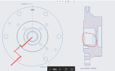

Hello Creo experts... I was hoping to reach out for some detailing help.

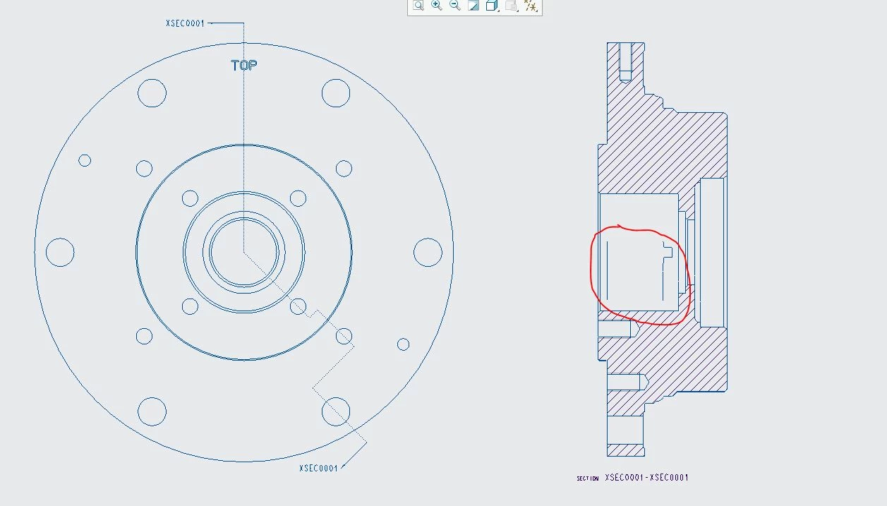

I have a part where several holes on different BC's need to be shown on an offset section view. If I do a offset section with only 2 lines, the view is fine but as soon as I 'jog' the section to go thru more holes, my offset section Full(Aligned) has geometry that is impossible to be erased. I have attached 2 images. 1 showing that if I have a relatively simple offset the section view is fine but as soon as I try to offset thru other features, the section view has extra geometry showing in the bore that I cant erase 😞

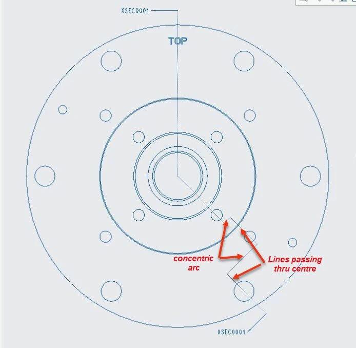

Try to change your sketch to something like attached. Sometimes this method works with the offset section.

For some reason, I have better luck when the x-section rotates the "other way".
Graphically like this:
Also check to make sure any cosmetics or sketches are hidden (or layers off) .

Thanks for taking time to reply...changed as you suggested but still have the lines in the bore that wont erase 😞

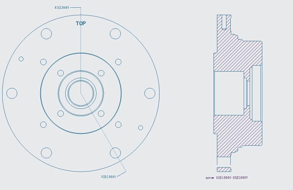

 not having the view as projected and RESULT!
Thank you!!!!
