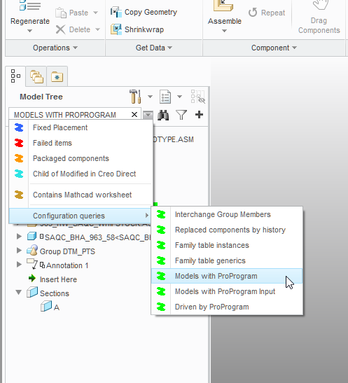

I'm having one big assembly,Thats like 500+ part is there..i did pro program in some parts..so now how i could find and,how many & what are the parts having pro program in assembly. Because i'm not like open 500+ parts..

Already i did..but now i cant do rename and change...because i cant search 500+ parts..so now there is any possible do to find ?

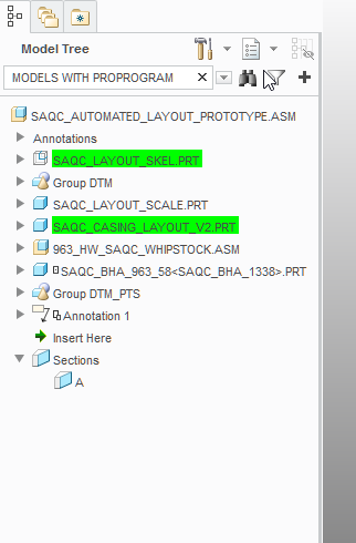

February 16, 2017
In the model tree of your top-level assembly, type "MODELS WITH PROPROGRAM" in the search box and press enter. It will highlight the model names. You may need to expand all levels. You can also use the menu dropdown for various other queries.
