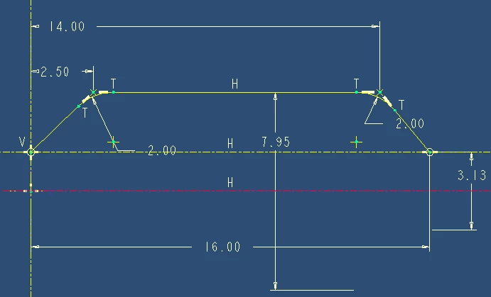

It uses two graphs: One called Radius and the other called Turns. Pictures of typical graphs are attached. Graphs are a kind of Datum feature.
The centerline of the spring is a datum curve driven by equation using a cylindrical coordinate system. Since I happened to chose an X extent from 0 to 16 in the graphs, the number 16 is used in the relations for the equation. You may choose a different length. You don't have to use the entire graph extent. "t" in the equations is a Pro/E supplied variable that is evaluated over the range of 0 to 1. Unless you want kinks in the spring, keep all transitions between entities in the graph tangent.
r =evalgraph("radius",t*16)
theta = 360*evalgraph("turns",t*16)
z=16*t

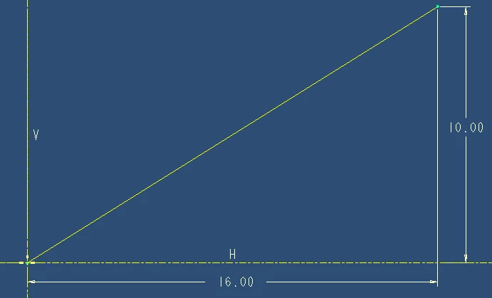

Notice that the turns graph changes from 0 to 10 along a straight line. Some other curves are possible, though Pro/E may balk at the next step, creating a solid. Adjustments to accuracy may be required.

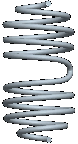

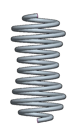

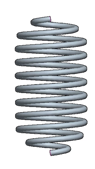

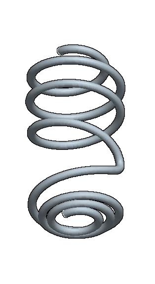

David Schenken‌, do you think you could add pictures of the related graphs for a couple of the springs shown above?
