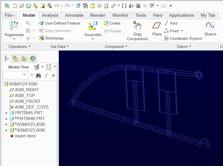

I have a subassembly (a pneumatic cylinder) which is used several times in a main assembly. The cylinder piston is constrained with a mecanism constraint (cylinder) so that it moves in and out. When I drag one piston all pistons from that subassembly moves, I would like to be able to move each piston individualy. Is that possible?

You will need to make the subassembly flexible so that the each can act according their own constraints.
Highlight the sub-assembly in the model tree, RMB and "Make flexible".  At that pont, you should be able to select a parameter that allows the sub-assembly to vary.  Be sure that it is not over-constrained.
Try flexibility in a smaller test assembly if you have trouble.

I probably should have added a few caveats.  I am assuming you have the piston locked in some library version that is locked to some known dimension.  Locking regeneration values in mechanism assemblies have stopped things from moving for me at higher level assemblies.
So the safe way is to make the mechanism element in the sub-assembly flexible and manage it in the higher level assembly.  It all depend on the level of geometry control you are required to incorporate.
However, making a component flexible is not necessary in all cases.  Evaluating a system that is locked up is AGONY!  So much so that I simply start over if the project can manage it.

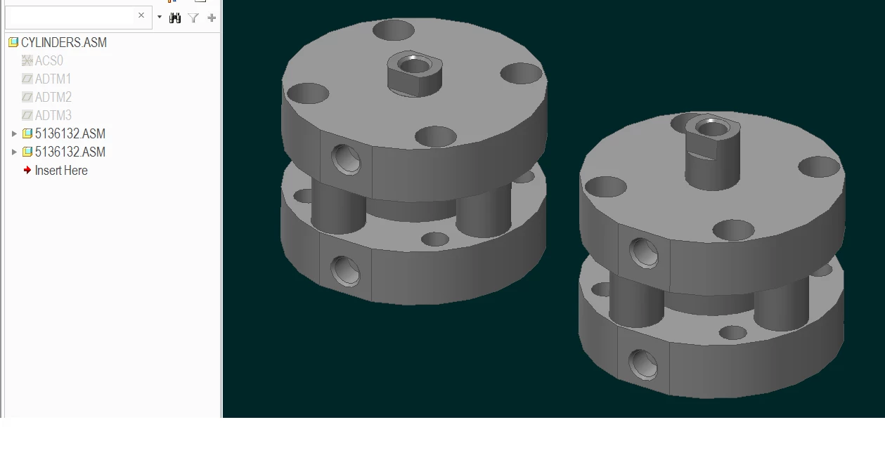

I've attached a file, commercial core Creo 2.0, that you can lift (drag component) the upper knob and the two identical cylinders will work correctly in real time.
Enjoy.

Note: if you don't have the "enable regeneration value" ticked off, then you should be able to place the cylinders in the parent assembly and move their pistons independently:
