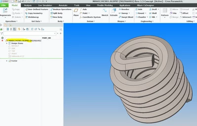

I was able to open a previous version with no issues:
something changed when new version SW file was "checked-in" ?

Apr 7, 2025 4:11 PM UTC
