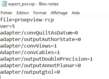

It is impossible for me to open my files generated in pvz by Creo on my Ipad through the CreoView app.
Here is my export configuration file :
I load my file on icloud, chose send to Creo View, the app opens and... nothing happened.
Any solution or advices ?
Thanks in advance.

I follow all the steps given by asun-2 on "CREO View on iPad" and.... nothing happens...
I modify the export config file, the thumbnail export file, use the master rep and style, check the files into the pvz by renaming it in zip.
I don't understand, it's witchcraft.
