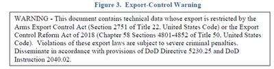

Let's take export control. In U.S., there are 3 buckets; ITAR, EAR or EAR99. DODI 5230.24 directs to place what I like to call the go to jail text. I am sure many of you have something like this on your drawings today.
What I am looking to do is key off an attribute that indicates if the items are ITAR, EAR or EAR99 and either show this block or not. I have seen that rule based layers could be used to turn this on or off. However, I believe this would require the use of drawing templates.  I do not believe this could be passed via formats but if so, open to that idea. The other option I have considered is adding a custom button for users to add or remove it which would be a manual step. I am really trying to avoid a manual step.
Currently, we have employed attribute based marking where the jurisdiction (ITAR, EAR or EAR99) is displayed on the drawing. The nice thing about this is that it does not require touching the drawing since we can control this from the Windchill level and push down (using Security Labels).  Ultimate goal would be if the drawing (or model) security label is a certain value, display the warning statement. Thoughts?
