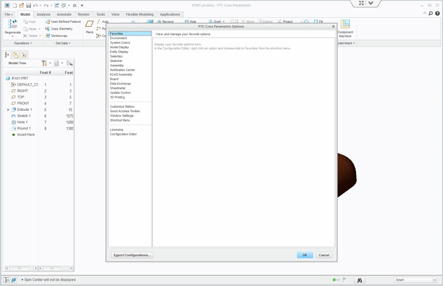

Options Box Resize
When opening the options box in creo 3.0 it is too large and out  of screen. When I try to drag and resize it for some reason creo doesn't allow this... Is there a way to resize the options box? As you can see in the picture the top of the box is outside of the screen along with the bottom. Thanks for the help.

Check your windows settings.  I seem to recall that Windows 10 (by your screen shot it looks like that's what you're running) defaults to making everything 125% for some reason.  I don't have Windows 10 here so I can't check it, but I remember dialing that down on my home PC right away..

what is the resolution of your monitor ? I use 1920x1200.

Hey,
Thanks for responding. The monitor is 3200x1800 and that is what this picture was taken in. However, I have lowered the resolution to see if that is the issue and have tried 1920x1080, 1920x1440, 1600x1200, and even 1080x960 with the same result. (I don't have the option for 1920x1200)

Robert,
I tested 1680x1050 resolution, see the following picture.
I guess that you changed default font size for your Creo on your PC.
Check config.pro options ... default_font affects options box size.
