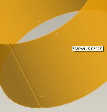

What is the easiest way to ordinate dimension a rolled part. I have holes that were created in the bent state. The flat instance deforms the holes so there is no axis or center location for the holes. Auto-ordinate dimension just gives the tangent locations of the deformed hole. There should be an easy way to do this right?

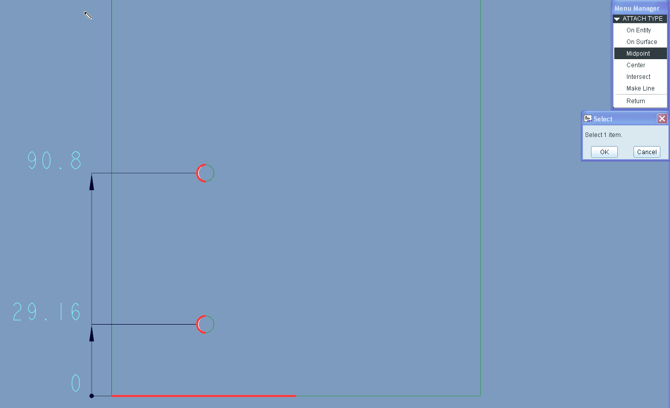

What you can do is select midpoint when placing the ordinate dimension. See in attached picture.
