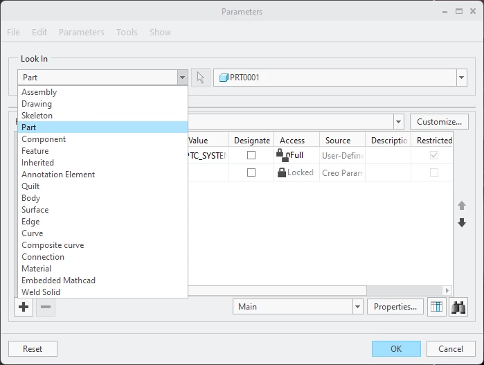

Is there anywhere where the Creo parameter types are organized?
For example,
&Model_name : ???
&sheet_number/&total_sheets : ???
Like this...

The parameter editor will display all parameters available in a file. Keep in mind that there are many different types of parameters in Creo and they are structured to data objects (sketch, feature, model etc.). Using the parameter editor, you should be able to filter all valid parameters for a Creo data object.
Tools tab-> Parameters
Nov 12, 2023 7:16 PM UTC
please read https://www.ptc.com/en/support/article/CS133915 document.

Thank you!!!😁
This is exactly what I was looking for.
