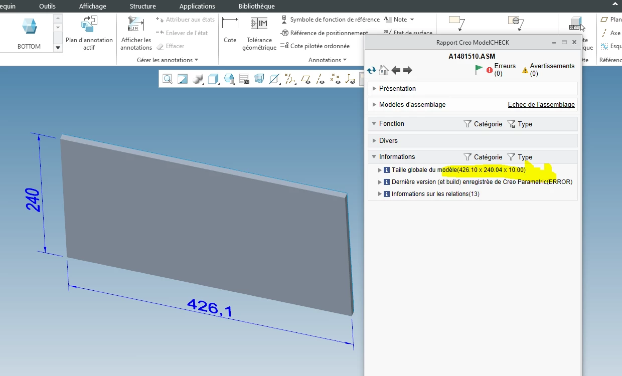

I would like to control the overall dimensions of my assemblies in Creo using ModelCHECK. The thing is, I design welded assemblies in Creo, and I need ModelCHECK to send me an alert message whenever I exceed a certain overall size.
I’ve already managed to create an overall size parameter and display it in the ModelCHECK interface, but I haven’t yet succeeded in comparing it to my threshold values and triggering an alert when the overall size exceeds those limits.
