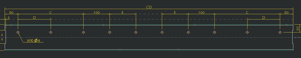

Is it possible to overide dimensions and show tolerance with it?

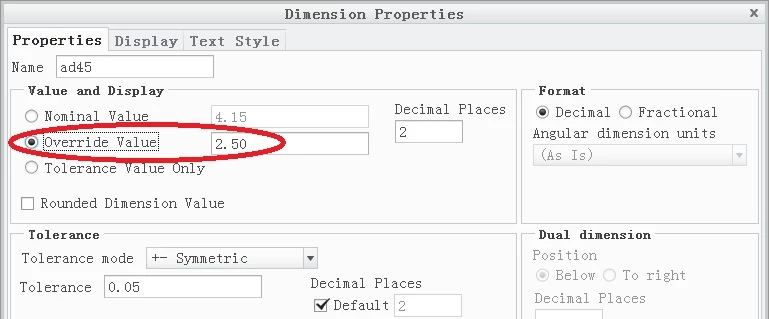

It's possible, use "Override Value" instead of use "@O", the tolerance is ok to with the dimension.

I want to show tolerance to overide dimension value CD
Regards

It seem the tolerance also be overrided, but you can type the tolerance value follow the override dimension value CD.
