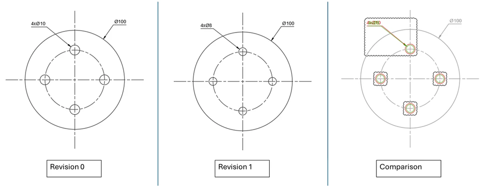

I am using Creo Parametric 11.0.6.0. In AutoCAD, there is a feature called compare with which we could compare the drawings and find out the changes that are made. Sample_Overlay.png
In the above image, the holes are changed from Dia 10 to Dia 8. On using the compare tool, the affected regions highlighted with cloud like marking.
Is there an equivalent feature in Creo that does the same function as above?

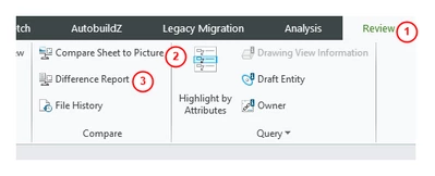

Dec 24, 2025 4:07 AM UTC
One can do the comparison at the Model Level too.
Check out Tools --> Compare Part
At the Drawing level:
