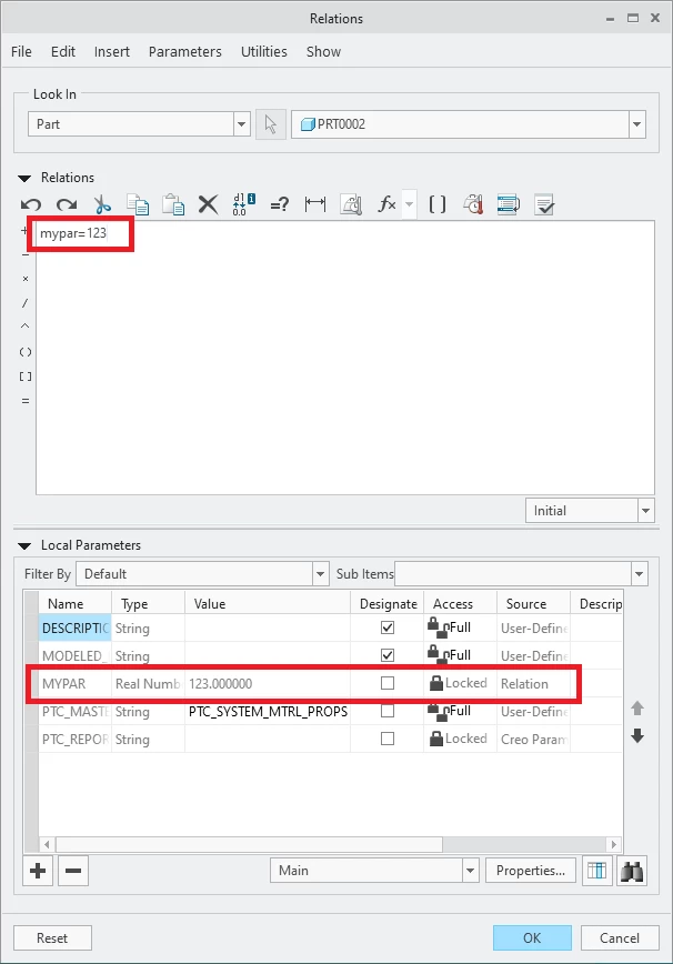

Hello, i have several parts that have locked paramters like this:
I cannot unlock this parameter and therefore I cannot change the value of it.
In the BOM in the drawing this parameter is linked. Is there a way to either unlock it or to overwrite this value in the BOM-table with a manual entry?
Greetings
Spedex

So as source it says "relation":
Unfortunately my Creo Parametric 9.0 Student Edition is in German. Sorry for that.
I do know the relation actually, it is linked to the file name. So whenever I update the filename this parameter updates itself too.
The question is can I remove this relation so that afterwards I can freely edit this parameter?
Greetings
Spedex
StephenW
Sep 20, 2022 12:07 PM UTC

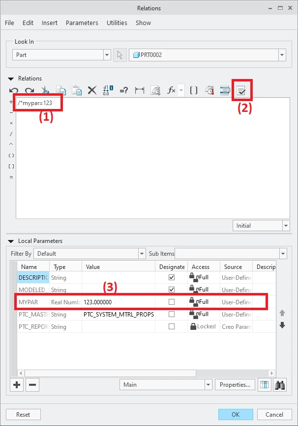

Yes, if you delete (or comment out) the relation, it will "unlock" the parameter.
You can add /* to the front of your relation to comment it out to test.
Spedex12-AmethystAuthor
Sep 20, 2022 2:53 PM UTC
Thank you very much everybody.
I was able to fix the problem by deleting the relations.
