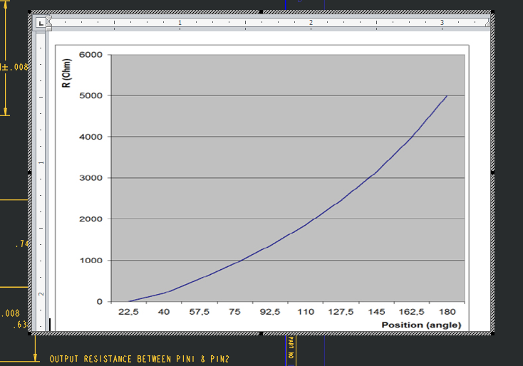

Hello All,
I am having a problem with paintbrush objects suddenly becoming invisible.
The above screenshot shows the drawing open in Creo 2.0 next to an exported PDF. The same paintbrush object is highlighted in both, but the contents of the object are invisible in Creo. This makes working with objects quite tedious because I can't see how they look without exporting to another format.
Has anyone else experienced this issue?

The picture is actually black text on a white background.Sorry, I guess I picked a bad example, here is a better one:
It also shows why I can't just use a note.
I tried the linked support solutions but couldn't find anything wrong with my registry entries. And here's what happens when I try to use a Word document instead of a paintbrush picture:
Works fine in edit mode...
Turns invisible on close...

Oct 8, 2015 12:40 AM UTC
I've had this problem since Pro|E... and still with Creo 3.
No rhyme or reason.  Restarting Creo seems to work.  Just cannot reproduce making it disappear.
I use a BMP file for a format title block logo.  Even when it is gone, it prints correctly.
One of those poor implementations that PTC is simply ignoring because it is so difficult to replicate but obviously there for many.
