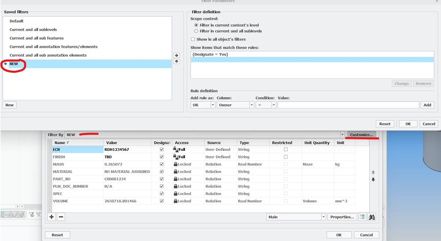

I am using Creo12,
is there any way to “save the customized parameters filtered view” so my part, assembly or drawing always open to new filtered view by default ? only need to see our “designated parameters”.
afer saving file, filtered view always reverts back to “default setting” - does not save my “new” filtered view.
thanks,
Rich

As a quick and dirty work around for this goal, you should be able to create a mapkey sequence to set up the filter definition. The settings in this UI are persistent in session AFAIK. Users can manually invoke the mapkey at any time and the filter will be set. If you want to automate then call a trail file that runs the mapkey when starting Creo in a startup script.
