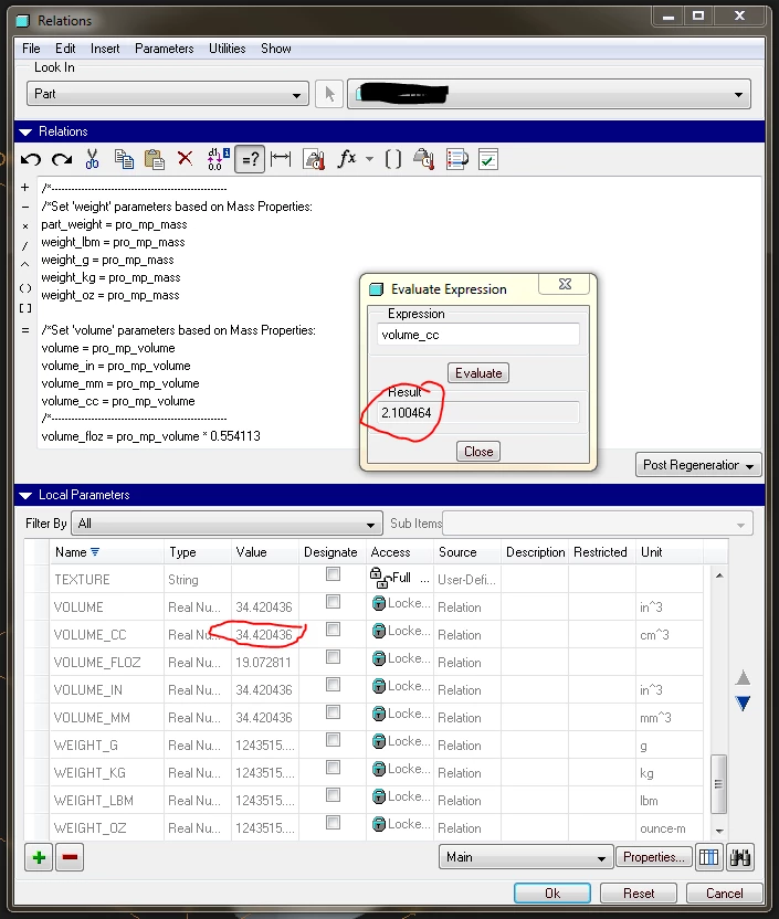

Yeah, still stuck on WF4 with several clients and I'm using the last build so I assume I'm out of luck ...
I'm using unit sensitive relations to drive several parameters so I can get volumes & weights in different units. It seems to work great but for one frustrating limitation. Regardless if I'm looking at the parameters in the relations dialog or the parameters dialog, the values displayed are usually incorrect. The values evaluate correctly, but they are displayed wrong. (see image below).
Is there any way to correct this?
