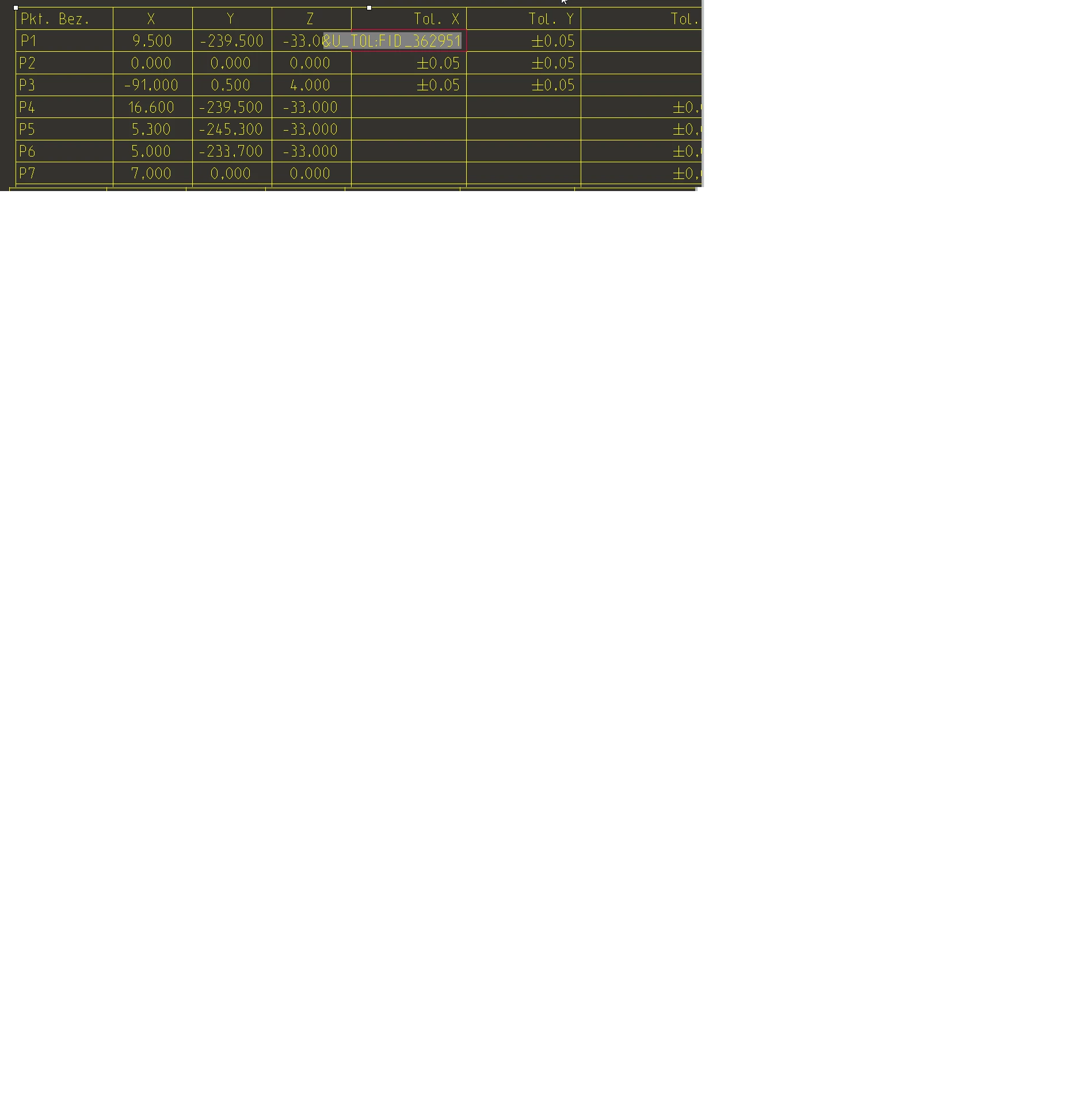

I have found a drawing with a unknown parameter
can help me with support about this problem?
i don't know where is it from ,

I think table is a hole table and the parameter &U_tol is feature level parameter to define tolerance. Check the relation in part for details about  &U_tol..
