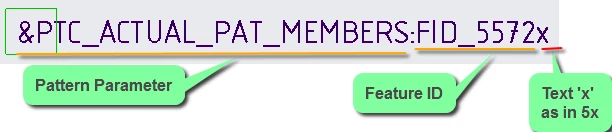

    I use &PTC_ACTUAL_PAT_MEMBERS instead of &p# and it works.
    Syntax to include the Feature ID
    Hope it helps.
